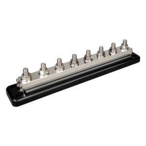

Victron Energy Busbar Rated for 600 Amps With 8 Terminals and Cover
VBB 600 8P
$222.70 $222.70 To see product price, add this item to your cart. You can always remove it later.
Part number: VBB160080010
Victron Energy 600 Amp 8 Terminal Busbar
Busbars are used for high current distribution and at the same time they provide connections for batteries and/or DC equipment. The busbar comes with a removable protection cover for added safety.
600 Amp 8 Terminal Busbar Specifications:
  • Maximum current: 600 Amps DC
  • Maximum Voltage: 70 Volts DC
  • Terminal diameter: 3/8 inch
  • Terminal material: Stainless steel
  • Busbar strip material: Tin-plated copper
  • Busbar base material: ABS
  • Busbar cover material: ABS
  • Weight: 2.9 lbs.
  • Dimensions (H x W x D): 2.6 x 12.9 x 3.4 inches
SKUVBB 600 8P
