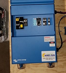

The VE Panel (VEP) is designed for the 3kVA and 5kVA MultiPlus and Quattro inverter/chargers
  • Internally pre-wired enclosure
  • A built-in AC bypass switch
  • Battery to inverter/charger DC disconnect breaker (250 Amps)
  • Inverter AC input overcurrent protection breakers
  • DIN mount AC and DC breakers
  • 500A/50mV DC shunt installed
  • Enclosure and components are UL/CSA certified and designated for indoor use
  • Configurations available for both single 120 and 230 VAC, 120/240 VAC and 3-Phase systems
  • DC negative, positive and ground busbars for DC loads and PV arrays included
  • Mounting provided for DIN rail DC load/disconnect breakers
  • Integrates directly with Victron Energy’s 3,000 and 5,000 Multi-Plus and Quattro inverter/chargers
  • Knockouts for inverter/charger and battery cables, PV in/out, DC panel mount breakers
