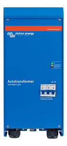

An autotransformer can be used for step up, step down and split phase output balancing purposes. While the step up and step down functions are fairly straightforward, split phase output balancing may require some more attention. If you have questions or would like product recommendations, please contact our engineers to discuss your application in greater detail.
Features and Specifications:
- Ground relay for use with Multi or Quattro Inverter/Chargers
- Temperature Protection
- Alternative to stacked inverters
- Input/Output voltage: 120/240
- Input circuit breaker: 50A, two pole
- Frequency: 50/60Hz
- Max 240V feed through current: 50A
- Neutral current, 30 min: 55A (3800VA)
- Transformer type: Toroidal
- Dimensions (h x w x d):18.11"x 8.42"x 4.33"(460mm x 214mm x 110mm)
- Weight: 25.3 lbs (11.5kg)
