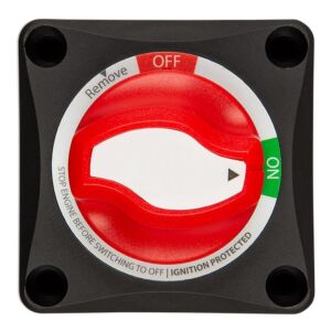

The Battery Switch ON/OFF 275A is suitable for battery systems up to 48V. It has a unique ergonomic and aesthetic knob design. The knob is removable for isolation or safety purposes.
The Battery Switch can be either surface or panel mounted, providing flexibility during install.
The Battery Switch meets the ISO8846 Ignition Protection standard and is suitable for use in an engine room.
  • Max. continuous current 275A
  • One minute rating 455 A
  • Cranking rating 1250 A
  • Voltage rating 60 V
  • Terminal material Tin-plated copper
  • Hex nut material Tin-plated copper
  • Terminal diameter 3/8 inch / 9.53 mm
  • Recommended torque 70 lbf·inch / 8 N·m
  • Base material Glass fiber reinforced nylon
  • Weight 0.4 lb / 0.2 kg
  • Dimensions (hxwxd) 2.7 x 3.0 x 2.7 inch
  • Mounting Surface or rear panel mount
  • Ignition protected
