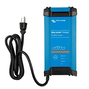

Blue Smart IP22 Charger
The Blue Smart IP22 Charger is the new professional battery charger with built-in bluetooth. The Blue Smart IP22 Charger can be used on devices in your workshop and on motor vehicles, such as (classic) cars; motorbikes; boats and camper-vans
The Blue Smart Charger features a microprocessor controlled ‘adaptive’ battery management. The adaptive feature will automatically optimize the charging process relative to the way the battery is being used.
Features and Specifications:
  • Input voltage range: 100-130 VAC
  • Charge current, normal mode: 30A
  • Charge voltage 'absorption': Normal: 14.4 High: 14.7 Li-ion: 14.2
  • Charge voltage 'float': Normal: 13.8 High: 13.8 Li-ion: 13.5
  • Charge voltage 'storage': Normal: 13.2 High: 13.2 Li-ion: 13.5
  • Weight: 2.86 lbs
  • Dimensions (h x w x d): 9.25" x 4.25" x 2.55"
