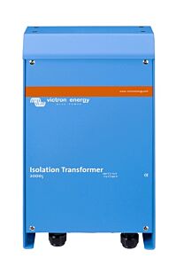

Victron Energy Isolation-Tr 2000-115/230 Transformer
Part Number: ITR040202041
Indispensable in professional marine energy systems. It prevents electrolytic corrosion and above all serves as a device to guarantee a safe electric system. Toroidal wound technology for quietness and high efficiency. Soft start circuitry will ensure that the shore circuit breaker will not trip when plugged in.
- Input: 115 or 230V
- Output: 115 or 230V
- Frequency: 50/60 Hz
- Rating: 17 / 8.5A
- Weight: 22 lbs
- Dimensions(H x W x D): 14.76in x 8.42in x 4.33in
