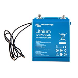

Victron Energy Lithium Battery Smart batteries are Lithium Iron Phosphate (LiFePO4) batteries that come in 12.8V or 25.6V with varying capacities. They can be connected in series, parallel, or series/parallel to create a battery bank for system voltages of 12V, 24V, or 48V. The maximum number of batteries allowed in one system is 20. This results in a maximum energy storage of 84 kWh in a 12V system and up to 102 kWh in a 24V or 48V system.
A single LFP cell has a nominal voltage of 3.2V. A 12.8 V battery consists of 4 cells connected in series and a 25.6 V battery consists of 8 cells connected in series.
  • Amp Hours: 50Ah
  • Voltage: 12.8V Nominal
  • Max Continuous Discharge Current: 100A
  • Weight (Battery Only): 15.4 lbs / 7 kg
  • Dimensions (H x W x D): 7.8" x 7.4" x 5.8" inches
  • Power connection (threaded inserts): M8
  • Operating Temperature (Discharge): -4° to 122°F
  • Operating Temperature (Charge): 32° to 113°F
  • Storage temperature: -40° to 149°F
  • Charge Voltage: 14.2 - 14.4V Absorption / 13.5V Float
  • Cell Type: LiFeP04
