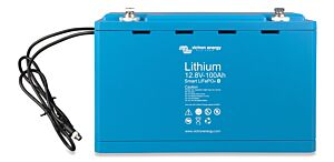

Victron Energy LiFePO4 12.8V/100Ah Battery
Note: A basic system for this battary to operate would have a least a BMS, a charge relay and load relay of some kind, but this will depend on what other equipment is in the system.
2500 Cycles 80
3000 Cycles 70
5000 Cycles 50
- Amp Hours: 100AH
- Voltage: 12.8V Nominal
- Peak Amps: 200 amps
- Life Expectancy: 2500-5000 Cycles
- Weight (Battery Only): 33lbs. / 15kg
- Power connection: M8
- Max Continuous Charge: 1C=200A
- Max Continuous Discharge: 1C=200A
- Operating Temperature: -4 to + 122 F
- Storage temperature: -49 to +158 F
- Charge Voltage: CC/CV 14.2V / Float 13.5V
- Cell Type: LiFeP04
