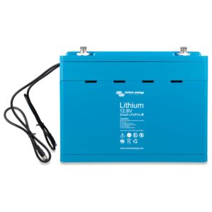

Victron Energy LiFePO4 12.8V/160Ah Battery
Note: A basic system for this battary to operate would have a least a BMS, a charge relay and load relay of some kind, but this will depend on what other equipment is in the system.
2500 Cycles              80
3000 Cycles              70
5000 Cycles              50
  • Amp Hours: 160AH
  • Voltage: 12.8V Nominal
  • Peak Amps: 320 amps
  • Life Expectancy: 2500-5000 Cycles
  • Weight (Battery Only): 39.68lbs. / 18.0kg
  • Power connection: M10
  • Max Continuous Charge: 1C=320A
  • Max Continuous Discharge: 1C=320A
  • Operating Temperature: -4 to + 122 F
  • Storage temperature: -49  to +158 F
  • Charge Voltage: CC/CV 14.2V / Float 13.5V
  • Cell Type: LiFeP04
