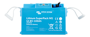

The Victron Energy Lithium SuperPack 12.8V/100Ah NG is a next-generation lithium iron phosphate (LiFePO4) battery with integrated Battery Management System (BMS) designed for reliable 12V off-grid, RV, marine, and backup power applications. The NG (Next Generation) series features improved monitoring, enhanced protection, and simplified installation compared to previous SuperPack models.
With a nominal capacity of 100Ah (1,280Wh) and built-in protection circuitry, this battery delivers safe, maintenance-free energy storage without the need for an external BMS. It is ideal for replacing lead-acid batteries in solar and mobile systems where long cycle life, lighter weight, and higher usable capacity are required.
  • On/Off push button: Push button for switching the battery on or off, disabling both charging and discharging functions to allow safe operation and extended storage time.
  • Bluetooth monitoring and control Includes Bluetooth Smart for wireless configuration, monitoring, and firmware updates via the VictronConnect App . The Instant Readout function displays key data such as state of charge (SoC), battery temperature, warnings, and alarms directly in the device list without the need to connect.
  • Built-in BMS and battery monitor: Integrates cell balancing, protection, and monitoring functions to ensure optimal performance and safety throughout the battery’s service life.
  • External Feedback Signal (E FS): Provides a battery voltage signal limited to 250 mA. The EFS signal serves as an External Disconnection Signal (EDS) to trigger an event for redundant system protection. Additionally, the EFS can be configured as an External Charging Signal (ECS), based on the low SoC pre-alarm threshold, to activate a charger start signal .
  • Self-heating function: Maintains the battery temperature above the minimum safe charging limit to ensure reliable operation in cold environments.
  • LED status indication: Two integrated LEDs indicate Bluetooth connectivity, warning and alarm conditions, or firmware update status.
  • Parallel connection: Supports parallel connection of an unlimited number of batteries to increase total energy capacity. The total system current should not exceed the maximum current that a single battery can safely interrupt.
  • Amp Hours: 100Ah
  • Voltage: 12.8V Nominal
  • Max Continuous Discharge Current: 100A(1C)
  • Weight (Battery Only): 23.6 lbs
  • Dimensions (H x W x D): 10.75" x 6.8" x 6.8" inches
  • Power connection (threaded inserts): M8
  • Cell Type: LiFeP04
