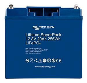

Victron Lithium SuperPack 12.8V/20Ah Battery
The SuperPack batteries are extremely easy to install, needing no additional components.The internal switch will disconnect the battery in case of over discharge, over charge or high temperature.
A Lithium-Ion battery does not need to be fully charged. Service life even slightly improves in case of partial charge instead of a full charge. This is a major advantage of Li-ion compared to lead-acid.The SuperPack batteries will cut-off the charge or discharge current when the maximum ratings are exceeded.
The batteries can be connected in parallel. Series connection is not allowed. Use in upright position only.
  • Amp Hours: 20Ah
  • Voltage: 12.8V Nominal
  • Max Continuous Discharge Current: 30 Amps
  • Weight (Battery Only): 7.7 lbs / 3.5 kg
  • Dimensions (H x W x D): 6.6" x 7.13" x 3.1" inches
  • Power connection (threaded inserts): M5
  • Operating Temperature (Discharge): -4° to 122°F
  • Operating Temperature (Charge): 32° to 113°F
  • Storage temperature: -40° to 149°F
  • Charge Voltage: 14.2 - 14.4V Absorption / 13.5V Float
  • Cell Type: LiFeP04
