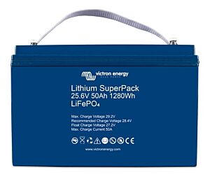

Victron Energy Lithium SuperPack 25.6V/50Ah Battery
LSP 25.6V/50Ah
$1,206.15 $1,206.15 To see product price, add this item to your cart. You can always remove it later.
Part Number: BAT524050705
lithium batteries cannot be shipped to Hawaii via UPS Ground. If you need this battery shipped to Hawaii, please email us or give us a call to place your order.
Victron Lithium SuperPack 25.6V/50Ah Battery
The SuperPack batteries are extremely easy to install, needing no additional components.The internal switch will disconnect the battery in case of over discharge, over charge or high temperature.
A Lithium-Ion battery does not need to be fully charged. Service life even slightly improves in case of partial charge instead of a full charge. This is a major advantage of Li-ion compared to lead-acid.The SuperPack batteries will cut-off the charge or discharge current when the maximum ratings are exceeded.
The batteries can be connected in parallel. Series connection is not allowed. Use in upright position only.
  • Amp Hours: 50Ah
  • Voltage: 25.6V Nominal
  • Max Continuous Discharge Current: 50 Amps
  • Weight (Battery Only): 30.9 lbs / 14 kg
  • Dimensions (H x W x D): 8.7" x 13.0" x 6.8" inches
  • Power connection (threaded inserts): M8
  • Operating Temperature (Discharge): -4° to 122°F
  • Operating Temperature (Charge): 32° to 113°F
  • Storage temperature: -40° to 149°F
  • Charge Voltage: 28.4 - 28.8V Absorption / 13.5V Float
  • Cell Type: LiFeP04
SKULSP 25.6V/50Ah
