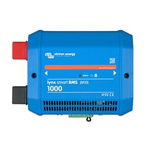

Lynx Smart BMS 1000A NG M10
The Lynx Smart BMS NG is a specialized Battery Management System (BMS) tailored for Victron Lithium NG batteries. These batteries use advanced Lithium Iron Phosphate (LiFePO4) technology and are available in 12.8V, 25.6V, and 51.2V models, with a range of capacities. The batteries can be configured in series, parallel, or a combination of both, enabling the creation of battery banks with system voltages of 12V, 24V, or 48V. A single system can include up to 50 batteries, supporting a maximum energy storage of 192kWh in a 12V system, or up to 384kWh in 24V and 48V systems. The total energy storage can be increased by connecting multiple Lynx Smart BMS units in parallel, providing additional capacity and redundancy in case of battery bank failure.
  • Built-in 500A or 1000A contactor used as a fallback safety mechanism and also suitable as a remote controllable main system switch.
  • Battery monitor, indicating state of charge percentage and more data.
  • Pre-alarm signal: provide a warning before the system shuts down due to -for example- a low cell
  • Bluetooth for use with our VictronConnect App, for setup and monitoring, including Instant Readout - key data of the BMS at-a-glance.
  • Local and remote monitoring using a Victron GX device, for example the Cerbo GX or Ekrano GX.
