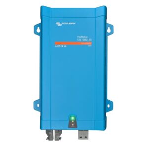

The Victron Energy MultiPlus range, covering 500VA to 1600VA, is a multifunctional power solution that combines a true sine wave inverter, adaptive battery charger, and a high-speed AC transfer switch into a single compact unit. It's designed to seamlessly switch to inverter mode during power cuts, ensuring uninterrupted power supply with transitions so quick that connected electronic devices continue to operate without disruption. Additionally, when paired with a GX device, it allows for remote monitoring and control through the Victron Remote Management platform.
Feature & Specifications:
  • PowerControl / PowerAssist: Yes/No
  • Input voltage range: 9.5 - 17Vdc
  • Output AC voltage: 120VAC
  • Output frequency: 60Hz
  • Continuous output power at 25°C: 1200VA
  • Peak power output: 2400W
  • Max efficiency: 93%
  • Zero load power: 10 Watts
  • AC Input voltage range: 95 - 140Vac
  • AC input frequency range: 45-65Hz
  • Charge voltage 'absorption': 14.4V
  • Charge voltage 'float': 13.8V
  • Charge current house battery: 50A
  • Battery temperature sensor: Yes
  • Dimensions(h x w x d): 15.98" x 9.84" x 3.94"
  • Weight: 18.04 lbs
