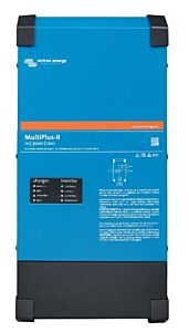

Victron Energy MultiPlus-II 3000 Watt 12 Volt Inverter, 120Volts AC & 120 Amp Battery Charger
Part Number: PMP122305120
Note: Please look at the newest model, 12/3000/120-50 120V Multi-II (UL 458).
Victron 3000W 12VDC 120VAC Inverter & Charger
The MultiPlus-II combines the functions of the MultiPlus and the MultiGrid. It has all the features of the MultiPlus, plus an external current transformer option to implement PowerControl and PowerAssist and to optimize self-consumption with external current sensing (max. 32A). It also has all the features of the MultiGrid with built-in anti-islanding and an increasingly long list of country approvals
The MultiPlus-II is the key component in a Victron ESS system, providing the flexibility to combine with MPPT Solar Chargers or Grid-tie PV Inverters.
The MultiPlus-II will prevent overload of a limited AC source, such as a generator or shore power connection. First, battery charging will automatically be reduced when otherwise an overload would occur. The second level will boost the output of a generator or shore side supply with power taken from the battery.
When coupled with a GX device (e.g. Cerbo GX) you can monitor and control your Multi and system or systems' locally (LAN) or remotely via the internet from anywhere in the world,, using the free VRM app and free VRM portal website. Access can be from a phone, tablet, laptop or PC for multiple operating systems. There is no end to the level of control, from adjusting your Multi to auto starting a backup generator and more…
Features and Specifications:
- Two AC Outputs
- Virtually unlimited power thanks to parallel operation
- Three phase capability (requires three MultiPlus units)
- Split phase options
- PowerControl - Dealing with limited generator, shore side or grid power
- PowerAssist - Boosting the capacity of shore or generator power
- Four stage adaptive charger and dual bank battery charging
- Input voltage range: 9,5 to 17 Volts DC
- Output voltage: 120 Volts AC +/- 2% @ 60 Hz
- Continuous output power (77° F): 3,000 Volt-Amps (VA)
- Zero load power: 13 Watts; 3 Watts in search mode
- Maximum battery charge current: 120 Amps
- Dimensions: 22.75" x 10.9" x 5.82" inches
- Weight: 41.9 pounds
- 5 year warranty
