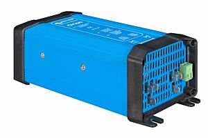

The remote on-off connector eliminates the need for a high current switch in the input wiring. The remote on-off can be operated with a low power switch or by the engine run/stop switch.
All models with adjustable output can also be used as a battery charger, for example to charge a 12 Volt starter or accessory battery in an otherwise 24V system.
All models with adjustable output can be paralleled to increase output current. Up to five units can be connected in parallel.
  • Input voltage: 18-35 Volts DC
  • Output voltage: 13.2 Volts DC (+/- 0.1 V)
  • Continuous output current: 40 Amps
  • Peak output current: 55 Amps
  • Efficiency: 95%
  • Non-Isolated
  • Dimensions: 2.6" x 3.5" x 7.3"
  • Weight: 1.9 lb
