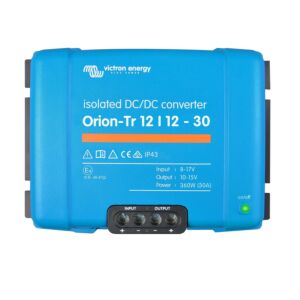

Victron Energy 12/12-30A Orion-Tr DC-DC Converter
The Remote on-off eliminates the need for a hight furrent switch in the input wiring. The remote on-off can be operated with a low power switch or by for examlpe the engine run/stop switch.
Adjustable output voltage: can also be used as a battery charger.
All models are short circuit proof and can be paralleled to increase optout current. An unlimited number or units can be connected in paralled.
IP43 protection when installed with the screw terminals orients downwards.
Input fuse on 12V and 24V input models only.
  • Input voltage range: 10-17v
  • Output Voltage adjust range: 10-15V
  • Continuous output current at nominal output voltage: 30 Amps
  • Max output current at nominal output voltage: 40 Amps
  • Efficiency: 87%
  • Dimensions(h x w x d): 5.1" x 7.3" x 2.8"
