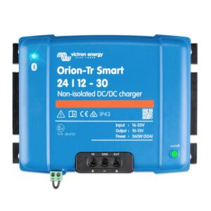

Victron Energy Orion-Tr Smart 24/12-30A
The Orion-Tr Smart DC-DC charger is a professional DC to DC adaptive 3-stage charger with built-in Bluetooth.
For use in dual battery systems in vehicles or on boats where the (smart) alternator and the start battery are used to charge the service battery. The unit can be monitored and programmed via Bluetooth and can be remotely controlled via a remote on/off switch and has an engine running detection mechanism.
The Orion Tr-Smart charger can be used in 12V or 24V systems and is suitable for both lead acid and lithium batteries. Models are available up to 360W and unlimited multiple units can be connected in parallel to increase output power.
  • Input voltage range: 20-35V
  • Output Voltage adjust range: 10-15V
  • Continuous output current at nominal output voltage: 30 Amps
  • Max output current at nominal output voltage: 45 Amps
  • Efficiency: 88%
  • Dimensions (h x w x d): 5.1" x 7.3" x 2.8"
