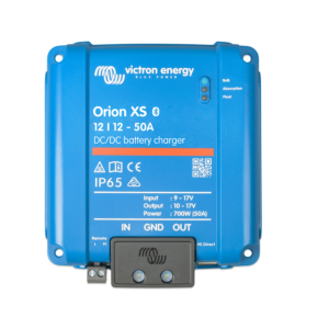

The Orion XS is a DC-DC battery charger that has been designed from scratch to redefine adaptive DC-DC battery charging. It is specifically engineered for use in dual battery systems that are charged with an intelligent alternator. This device not only ensures top-tier performance but also guarantees the safety of your system.
The Orion XS serves as a DC-DC battery charger or as a power supply, offering a wide input and output voltage range. This is especially significant in the case of vehicles with a Euro 5 or Euro 6 smart alternator, which often supplies too low charging voltage even when the engine is running or when extended cable lengths, as is often the case in boats and RVs, lead to voltage drops. In such scenarios, precise and controlled charging is imperative to fully charge the service battery while protecting the starter/input battery from discharge.
  • Input voltage range: 9-17V
  • Output Voltage adjust range: 10-17V
  • nput and output current setting range: 1-50 Amps
  • Maximum constant short-circuit current: 50 Amps
  • Efficiency: 98.5%
  • Dimensions (h x w x d): 5.4" x 4.85" x 1.86
