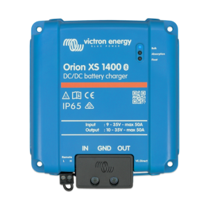

Victron Energy Orion XS 1400 DC-DC battery charger
he Victron Energy Orion XS ORI242417040 is a high-performance 12V to 24V DC-DC battery charger designed to optimize multi-battery system setups in mobile and off-grid applications. Delivering a robust 70A charging current, this model ensures efficient and adaptive charging from 12V input sources such as starter batteries to 24V auxiliary battery banks.
Featuring advanced VE.Smart Network compatibility via Bluetooth, the Orion XS intelligently communicates with other Victron devices for synchronized voltage sensing, temperature compensation, and current control. Its programmable input and output voltage settings, combined with fully automatic 3-stage charging, provide safe and flexible power delivery to LiFePO₄, AGM, GEL, and flooded lead-acid battery types.
Built for reliability, the charger includes reverse polarity protection, over-temperature shutdown, short-circuit protection, and an IP65-rated enclosure, making it ideal for harsh environments including marine, RV, and mobile installations. The ultra-compact design allows for versatile mounting with minimal footprint while maximizing thermal efficiency via active cooling.
  • 700W when charging a 12V battery bank from a 12V alternator.
  • 700W when charging a 24V battery bank from a 12V alternator.
  • 700W when charging a 12V battery bank from a 24V alternator.
  • 1400W when charging a 24V battery bank from a 24V alternator.
  • Input Voltage Range: 9–35V DC
  • Output Voltage Range: 10-35V (configurable)
  • Output Current setting range: 1-50A
  • Input Current setting range: 1-50A
  • Efficiency: Up to 98.5%
  • Bluetooth: Built-in (for setup and monitoring via VictronConnect app)
  • Operating Temperature Range: -20°C to +60°C
  • Ingress Protection: IP65 (dust and splash resistant)
  • Weight: 0.52 kg (1.14 lbs)
  • Dimensions: 138.1 x 124.4 x 53 mm (5.44 x 4.9 x 2.1 in)
