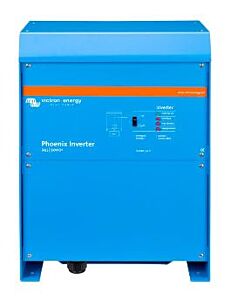

Victron Energy Phoenix 12/3000 120V Inverter
Pure sine wave output, high peak power and high efficiency. Combined high frequency and line frequency technologies ensure the best of both worlds.
SinusMax - Superior engineering
Developed for professional duty, the Phoenix range of inverters is suitable for the widest range of applications. The design criteria have been to produce a true sine wave inverter with optimized efficiency but without compromise in performance. Employing hybrid HF technology, the result is a top quality product with compact dimensions, light in weight and capable of supplying power, problem free, to any load.
Parallel and 3-phase operation capability. Up to 6 Phoenix Inverters can operate in parallel to achieve higher power output. Six 24V 5000VA units, for example, will provide 24kW / 30kVA output power. Operation in 3-phase configuration is also possible.
Feature & Specifications:
  • Output AC voltage: 120VAC +-3%
  • Output frequency: 60Hz
  • Continuous output power at 25°C: 3000VA
  • Peak power: 6000W
  • Max efficiency: 93%
  • Zero load power: 20 Watts;
  • Dimensions(h x w x d): 14.3" x 10.2" x 8.6"
  • Weight: 38 lbs
  • Warranty: 5 years
