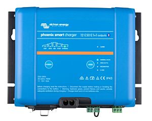

Victron Energy Phoenix Smart IP43 Charger 24/16(1+1)
With boat owners in mind this adaptive 5-step charger can provide either 30A or 50A of charge to each of three battery banks. Or the Phoenix 1+1 model provides 3A to the starter-battery, the rest to the ‘house’ bank. 24V models are available with 16A/25A charge. Bluetooth enabled, you can monitor the charger and set alarms straight from your phone. Adaptive, intelligent, dynamic charge features – see the datasheet below.
Features and Specifications:
  • Input voltage: 85-250 VAC
  • DC Input voltage range: 290-375 VAC
  • Maximum Efficiency: 96%
  • Charge current house battery: 16A
  • Charge voltage 'absorption': Normal: 28.8 High: 29.4 Li-ion: 28.4
  • Charge voltage 'float': Normal: 27.6 High: 27.6 Li-ion: N/A
  • Charge voltage 'storage': Normal: 26.4 High: 26.4 Li-ion: 27.0
  • Weight: 6 lbs
  • Dimensions (h x w x d): 7.1" x 9.8" x 4.6"
