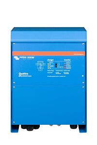

Victron Energy Quattro 10,000 Watt 48 Volt Inverter & 140 Amp Battery Charger 230 VAC
48/10000/140-100/100-230V
$2,606.95 $2,606.95 To see product price, add this item to your cart. You can always remove it later.
Part Number: QUA481030010
These single phase inverters can be programmed to output 240V 60Hz for North American applications. Couple with an Autotransformer to do neutral forming for 120/240V split phase applications. We can also stack these inverters in three phase configurations to do 230V/400V WYE (50Hz or 60Hz). For three phase 120V/208V applications the 120V Quattro inverters should be used. If you have questions or would like product recommendations, please contact our engineers to discuss your application in greater detail.
Victron Energy 10,000 Watt 48VDC Inverter & charger
Similar to the MultiPlus, the Quattro is also a combined inverter and charger. Additionally it can accept two AC input and automatically connect to the active source. Its many features include two sine wave inverter, adaptive charging, hybrid PowerAssist technology plus multiple system integration features such a three or split phase operation and parallel operation.
The Quattro can be connected to two independent AC sources, for example shore-side power and a generator, or two generators. The Quattro will automatically connect to the active source. The main output has no-break functionality. In the event of a grid failure, or shore or generator power being disconnected, the Quattro takes over the supply to the connected loads. This happens so fast that computers and other electronic equipment will continue to operate without disruption. The second output is live only when AC is available on one of the inputs of the Quattro.
The Quattro will prevent overload of a limited AC source, such as a generator or shore power connection. First, battery charging will automatically be reduced when otherwise an overload would occur. The second level will boost the output of a generator or shore side supply with power taken from the battery
