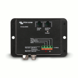

Victron Energy VE.Bus BMS
The VE.Bus BMS protects each individual cell of a Victron lithium-iron-phosphate (LiFePO4 or LFP) battery. Each individual cell of a LiFePO4 battery must be protected against over voltage, under voltage and over temperature. Victron LiFePO4 batteries have integrated Balancing, Temperature and Voltage control (acronym: BTV) and connect to the VE.Bus BMS with two M8 circular connector cord sets.The BTVs of several batteries can be daisy chained. Please see the LiFePO4 battery documentation for details.
  • Shut down or disconnect loads in case of imminent cell under voltage.
  • Reduce charge current in case of imminent cell overvoltage or over temperature.
  • Shut down or disconnect battery chargers in case of imminent cell overvoltage or over temperature.
