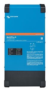

Victron MultiPlus-II inverter & charger 3000 watts, 12 Volts DC, 2x120 Volts AC, 120 Amp charger
12/3000/120-50 2x120V (UL 458)
$1,088.00 $1,088.00 To see product price, add this item to your cart. You can always remove it later.
Part Number: PMP122305102
Note: THE PRODUCT IS SPECIFICALLY DESIGNED FOR INTEGRATION in 50A RV APPLICATIONS. THIS MODEL INCLUDES A TWO POLE 50A AC INPUT/OUTPUT. IF YOU ARE LOOKING FOR THE MODEL WITH A SINGLE POLE AC INPUT/OUTPUT, PLEASE LOOK AT THE 12/3000/120-50 120V MULTI-II.
Victron 3000W 12VDC 2x120VAC Inverter & Charger UL 458
This product is specifically designed for interrogation with 50A RV applications. This model includes the two pole 50A AC input/output.
The MultiPlus-II combines the functions of the MultiPlus and the MultiGrid. It has all the features of the MultiPlus, plus an external current transformer option to implement PowerControl and PowerAssist and to optimize self-consumption with external current sensing (max. 32A). It also has all the features of the MultiGrid with built-in anti-islanding and an increasingly long list of country approvals
The MultiPlus-II is the key component in a Victron ESS system, providing the flexibility to combine with MPPT Solar Chargers or Grid-tie PV Inverters.
Up to 6 Multis can operate in parallel to achieve higher power output. Three phase or split phase operation is also possible. Please check our datasheets to see which models have paralleling, three phase and split phase capabilities.
When coupled with a GX device (e.g. Cerbo GX) you can monitor and control your Multi and system or systems' locally (LAN) or remotely via the internet from anywhere in the world,, using the free VRM app and free VRM portal website. Access can be from a phone, tablet, laptop or PC for multiple operating systems. There is no end to the level of control, from adjusting your Multi to auto starting a backup generator and more…
Features and Specifications:
  • Two AC Outputs
  • Split phase options
  • Input voltage range: 9,5 to 17 Volts DC
  • Continuous output power (77° F): 3,000 Volt-Amps (VA)
  • Zero load power: 20 Watts; 8 Watts in search mode
  • Charge current (house battery): 120 Amps
  • Maximum battery charge current: 120 Amps
  • Dimensions: 14.3" x 10.2" x 8.6" inches
  • Weight: 40 pounds
  • 5 year warranty
SKU12/3000/120-50 2x120V (UL 458)
