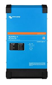

Victron MultiPlus-II inverter & charger 3000 Watts, 48 Volts DC, 120 Volts AC, 35 Amp Charger
Part Number: PMP482305100
Note: This product has been discontinued, please look at 48/3000/35-50-120V(UL). Should you need assistance or if you would like to explore alternative recommendations, please Contact Us or call us directly at 800-383-0195.
The MultiPlus-II combines the functions of the MultiPlus and the MultiGrid. It has all the features of the MultiPlus, plus an external current transformer option to implement PowerControl and PowerAssist and to optimize self-consumption with external current sensing (max. 32A). It also has all the features of the MultiGrid with built-in anti-islanding and an increasingly long list of country approvals.
Monitor and control your MultiPlus and system or systems' locally (LAN) or remotely via the internet from anywhere in the world, using the free VRM app and free VRM portal website. Access can be from a phone, tablet, laptop or PC for multiple operating systems. There is no end to the level of control, via the required Color Control GX or Venus GX.
Features and Specifications:
- Two AC Outputs
- Virtually unlimited power thanks to parallel operation
- Split phase options
- PowerControl - Dealing with limited generator, shore side or grid power
- PowerAssist - Boosting the capacity of shore or generator power
- Four stage adaptive charger and dual bank battery charging
- Input voltage range: 38 to 66 Volts DC
- Output voltage: 120 Volts AC +/- 2% @ 60 Hz
- Continuous output power (77° F): 3,000 Volt-Amps (VA)
- Zero load power: 13 Watts; 3 Watts in Search mode
- Maximun battery charge current: 35 Amps
- Dimensions: 22.75" x 10.82" x 5.8" inches
- Weight: 48.5 pounds
- 5 year warranty
