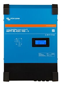

The SmartSolar MPPT RS solar charge controllers are Victrons solution for systems with large series connected PV arrays charging 48 V DC battery banks. This product is perfect for large off-grid, and grid connected battery systems.
Available in a 5.76kW and 11.52kW model, features include a wide 80-450 VDC operating solar voltage input, independent tracking inputs, full connectivity, isolated PV connections, display screen, fully programmable battery charging parameters and active cooling. The new metal case design and fully covered electrical connections improve the safety and modernise the presentation in line with the latest suite of Victron products.
The SmartSolar RS solar charge controller connects to a PV array of between 80 and 450 Volt Voc and will efficiently charge your 48V battery bank with either 100A or 200A. The charge settings are fully programmable and can be set up for different battery chemistries, like lead-acid, lithium and more.
The SmartSolar RS charge controller is equipped with VE.Can bus ports. This allows for communication with additional SmartSolar RS & VE.Can MPPT units. The additional units are simply “daisy chained” to each other with an RJ45 cable. When connected to each other, all individual charge controllers, will synchronise their charge stages.
The SmartSolar RS charge controller is equipped with a display on the front panel. The display reads battery volts, charge current and voltages from both array’s individually including instantaneous and total figures and unit status including any possible error codes.
The SmartSolar RS charge controller is equipped with a programmable relay and options for remote temperature and voltage sensing. The remote input can accept the Victron smallBMS and other types of BMS with allow-to-charge signals.
  • Maximum charge current: 100 Amp
  • Maximum DC PV Voltage: 450 V
  • MPPT operation voltage range: 80-450 V
  • Number of trackers: 2
  • Weight: 17.4
  • Dimensions: 17.3" x 12.3" x 4.96"
  • 5 Year Warranty
